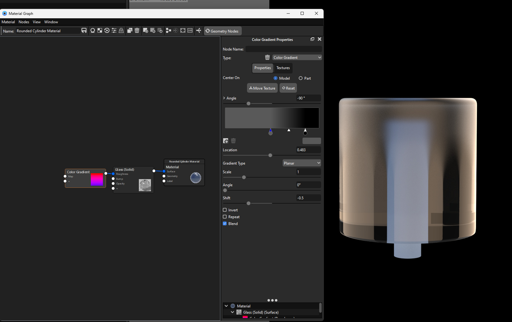

Maybe it’s something that is super easy and I am just super bad, but I am struggling to make this.
I need to make a fading frosting on a glass cylinder; I need it to be transparent on the lower part and frosted on the top;
I am attaching an image to explain better.
Please let me know,
bye bye!
G
Hi,

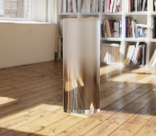

You should try a gradient texture to set the roughness of your glass material.
Then, tweak the size, texture position and color points to match your needs.
You can also create the frosted look with a label material, and control the fade with a black and white gradient in the opacity channel of the label. that would give you seperate control of the look of the clear part and the look of the frosted part.

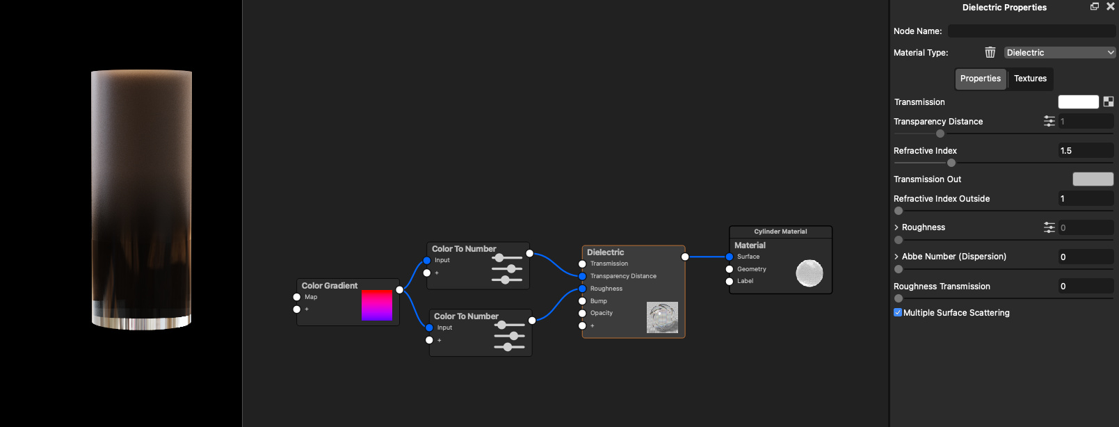

You can emphasize the effect by using ‘Dielectric’ and control both roughness and transmission distance at the same time.
